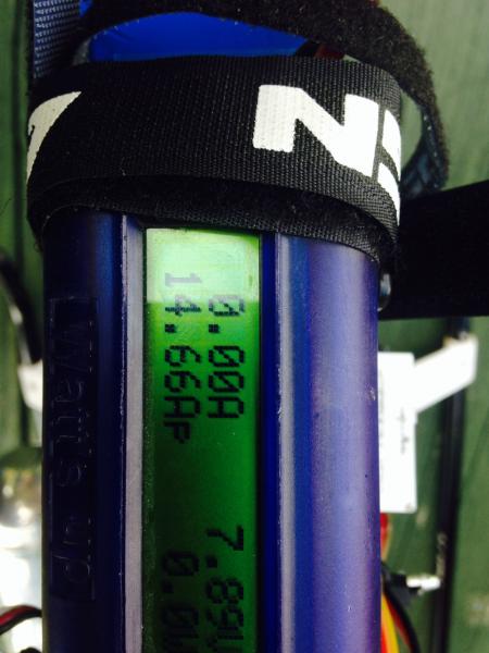

    Flight control system power requirements in a model are often over-looked, more so when an already flying model is converted or has it's setup changed to new hardware and so is taken for granted that it will all work as before.
    During a recent conversation with a UK masters pilot, it transpired that one of our fellow team members had experienced and inflight problem while testing his newly fitted Gpro into one of his working 700E's to give it a whirl. He was very impressed with it's performance I may add, however on the 3rd flight experienced what I have determined (going by the explanation of what happened and some new data) to be an inflight reset of the Gpro due to a drop in BEC volts.
    Now this guy has been using a Kontronik Heli Jive ESC/BEC combination with another setup all ok, the BEC's output of 5amps continuous in my eyes is too low for a 700 class machine, but it was working and so was used as before.
    This change to the Gpro has highlighted a potential problem with low rated BEC's again, in similar fashion to the 3GX as Align increased it's performance with new firmware releases and so current draw/demands increased.
    Originally the owner was sceptical that the BEC could be at fault and as we all know, after a crash it's very difficult to determine the true cause, but based on the data he then collected after I'd spoken to him about similar issues the 3GX had, I think he's now resigned to the same conclusion.

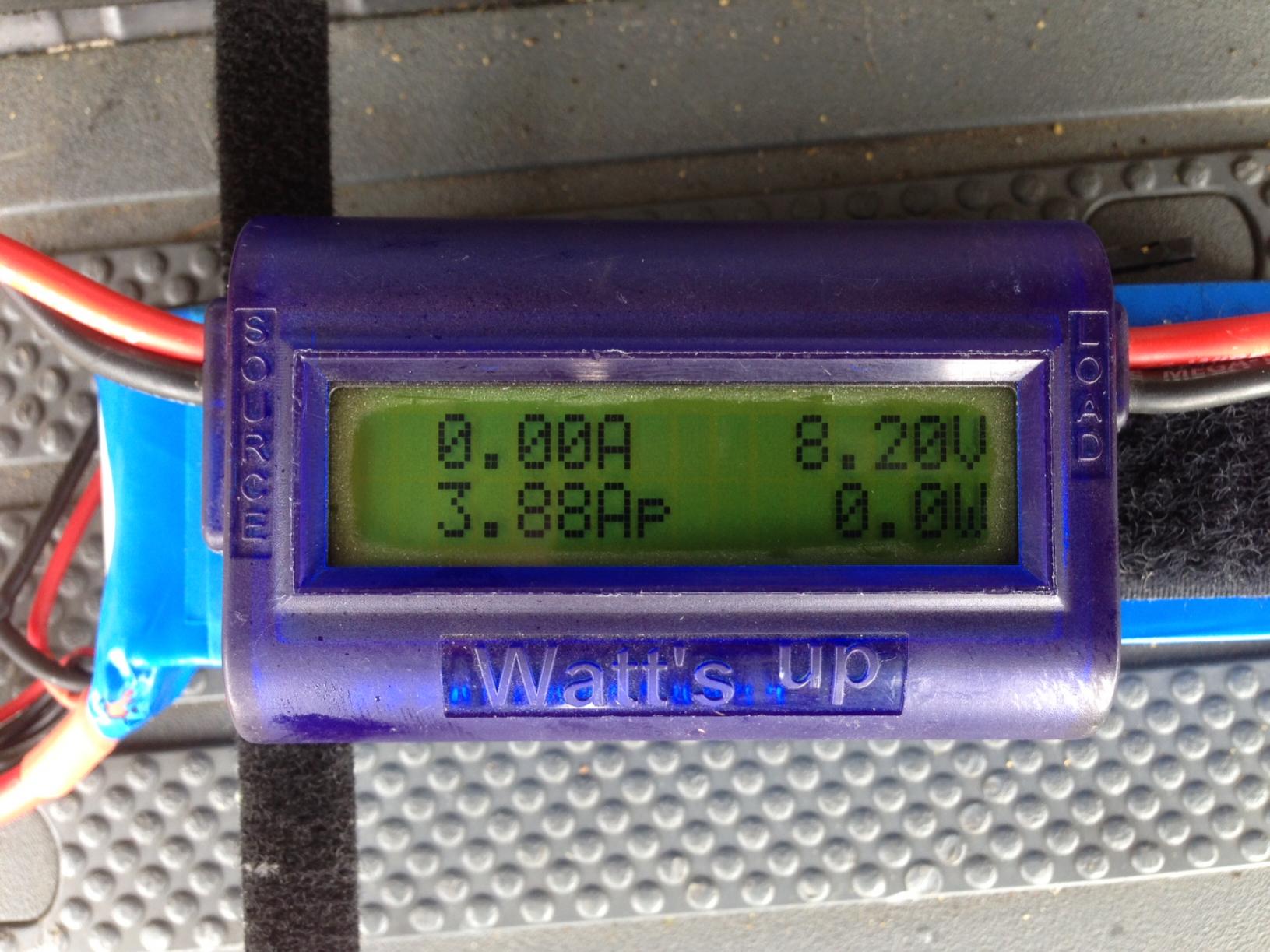

    Two identical models were compared only differing in their FBL units, in this case Align 700N DFC's, with the 1st using a Vbar and the 2nd was flown by Duncan Osbourn with the Gpro. The latter may have been flown harder perhaps, but the great difference in readings was substantial enough in my eyes to prove the theory that it was a power related problem.
    Unfortunately I don't have an Eagletree unit to get some nicer readings, so a Watt Meter was employed to record the maximum amps drawn in flight.
    The Mini Vbar returned a 3.88 amps max current draw and the Gpro (in Duncs hands) 14.66 amps max. A startling difference.
    My purpose of this post is not to put blame on one unit, but to highlight the need to make sure the power supply setup to your servos fitted to your models is up to the job to avoid potential problems.

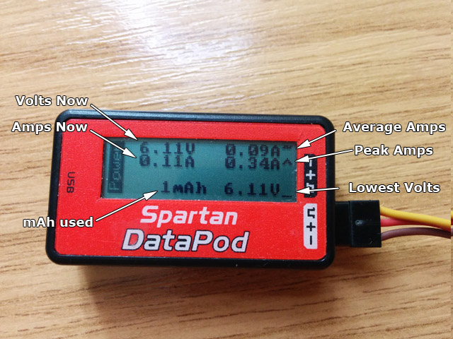

    The Vortex I use for R&D has an additional circuit board inside that allows it to measure the current that goes to the servo outputs. Similar thing you tried to do with your Watt's Up however mine has a smaller range of 16A thus making it more accurate to small currents. Every time we test new algorithms we compare the average current between flights and we have made significant reductions on the average current using it as guidance.
