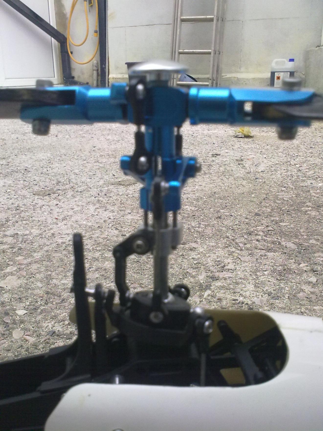

            Its for a 500, ideally I just want to buy the bits I need to convert a flybarred head as I have a spare one. Can this be done and if so which parts are required for a fbl conversion?

              you can make your own like i did
                Just like the old days, when you had to make the parts for the heli before you could build it!

                    Its for a Trex 500, wanted to convert the standard trex 500 flybarred head but not sure which parts of the 3g fbl head I would have to buy and which could be re-used from the flybarred head.
                    Sam
                      RC Heli Magazine :: Learn How To :: TREX 500 Flybarless Conversion here you go cheap as chips alternatively you'd need the blade grips,washout arms and links to convert the flybared head (i'm pretty sure you can use the original head it just has a few unused holes in it)
                        Fast Lad Performance
                        you could use that head conversion with 3g, there all the same really, just look different, the above that glen has pointed out is exactly how i did my 250 and 450
