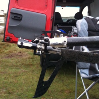

        No the lead that goes to the sensor came out and sent the tail spinning out of control. Bent the shaft and done the tt gear and the rest I managed to save but on a plus not just done a hurricane with the 450 pro for the first time

                          I bent the tail output shaft so I could not get it repaired as I not got one of those but everything else seemed fine.
                          I could tell that it was very sensitive so I will up the expo for next time but I will defo be using a small dab of super glue, just enough to hold it in and stop it coming loose again.
                          It will most defo be ready for next weekend but cos it done the TT gears I got to do that poxy job again, a real pain in the ass on the 600. Is it just mine or is the tail boom block a complete ass to seperate?
