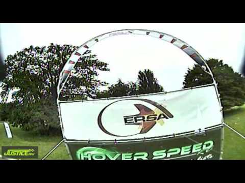

            EDIT: There is an argument for going 5S or 6S, and that is to put less stress on the batteries. Sadly, the right motors to enable that to happen don't really exist. Batteries are the big bottleneck in racing right now. I shall now demonstrate how one of the best batteries on the market (Revolectrix blend 435 1500mah 4S) can be flattened and have to be thrown in the bin in just 2 minutes:
