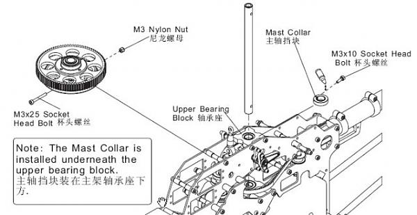

    Good call Paul, main shaft would of lifted 1st pull on the sticks, Collar should be under the upper bearing block with the raised part towards the bearing but above the A arm shaft, it needs to sit in between other wise it wont lift fully..

      I have had a fiddle with the heli, moved the mast coller under the upper bearing (thanks Paul) - didnt check for a way up on the collar though - will check before I pop out for a summer beer.
      The location of the collar is not that clear in the manual, I just assumed it was the same as the Trex and almost every other heli I have had :)

        [url]http://www.rcheliaddict.co.uk/showthread.php?t=9814[/url]
        [quote]The location of the collar is not that clear in the manual[/quote]
        Did you not download the new one?
        Page 9-21 "Mast collar is....." in the box to the side.

          [quote=rspblake;134356][url]http://www.rcheliaddict.co.uk/showthread.php?t=9814[/url]
          Page 9-21 Mast collar is.....[/quote]
          ....shown above the bearing by virtue of the extension line drawn from the collar being above the bearing ;)
          It is the same manual from what I can see.. I think I automaticaly (irrespective of the manual) put it up top as that is what most other heli's are :).
          **EDIT** Sorry Rob - you are right, there is a box on there - new clip attached! :)
