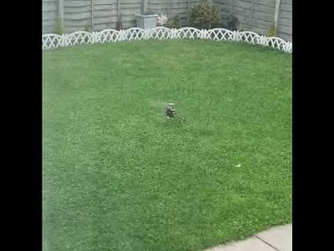

      The other issue I had and is evident in the video below was a very nasty head wobble the minute the model left the ground and I chased my tail trying to work out what was going on here. In the end it seems that if the geometry 6 degree setup needs to be over a certain value to see 6 degree's on the blades, then the unit simply does not like it and as the manual asked for 6 degree's I set the model up like this.
      It was advised to try lower and was I mesuring the pitch right....... sorry but after 40 years in this hobby I know how to measure the pitch right. So out of desperation I dropped the value from the high 170 to 120, which gave 3.4 degrees on the bench and the model finally hovered.
      In fact now I am at 90 and had to combine this with removing all the elevator filtering by putting it to zero, but I am observing a bounce on the boom if I quick stab elevator inputs which I am yet to rectify.
      My little boy isn't happy in the background, but I was happy to have him stood beside me with it doing this for no apparent reason;
      My personal feeling is this unit isn't going to see the tail channel fix it needs, certainly there has been no indication on their forum that it will be and I've made a post in the bug fix section also with no response.
      Never been one to complain about anything in the RC world, but this unit is a let down for me on the smallest of details, especially as most seem to hold the Spirit units in quite high regard and quick action to rectify issues.

          Ian, I guess you have tried reducing cyclic gain?.. It certainly looks like cyclic gain that's too high.

              Morning Mate.
              Yeah after seeing that if was the first thing I and any of use would go to, so I dropped the stock 55 by 10 points, which didn't help, then 20 an finally all but switched off the gain by placing it at the lowest setting of 20% and it still wobbled.
              Essentially these wobbles stemmed from the need to have the geometry 6 degree slider so high in it's range to get the required 6 degrees on the blades. Why this high value gave these issues I do not know and the Spirit guys haven't been able to offer an explanation either, only that it is very high and might be the cause.
              As you saw I ordered some OMP balls Thursday so have fitted the longer ones to the inner ring of the swashplate in an effort to bring this geometry slider down as much as I can and I'm still considering trying to move the blade grip balls in as well, because the collective travel slider is quite high also to achieve a +-12.5 degree range.
              I even went up and down on the head speed, thinking as I have changed the ESC(s) I may be in the RPM band where the M2 wobbles, but this simply increased or decreased the wobble frequency.
              Strange one, within reason I was expecting to be able to follow the manual and then hover. Follow this with the usual fine tuning and be happy, but there is some gotcha's in the parameters it seems whereby if they are too high they cause other issues. At least this is my thoughts so far.
