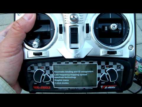

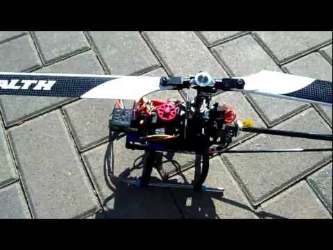

                        It looks like this helicopter is a rebranded version of the 2.4Ghz Walkera V400D02 6-Channel Flybarless CP Helicopter. Which means all the spare parts are the same including the RX/TX compatiable. There is a brushleess Main Motor Kit available for the Walkera V400D02 as well as other mods that should work for the Century Clone.
                        • #42
                          The Century Neon Blaze (SE) is a clone of the Walkera V400D02. It is a nice beginner's FLYBARLESS 6-Channel CP Helicopter. It uses a tail motor which makes it very easy to repair. Additionally, with the 3G (#-Axis Gyro Technology), it makes the flybarless helicopter possible to fly. No more flybar rods and paddles also makes it easier to repair the main rotor section. We also did some mods for this helicopter including a Main Brushless Upgrade, Metal Gear (MG) Servos, Stealth Carbon Fiber Blades 531mm, Super Skids 400, larger LIPO Battery, ON/OFF Power Swith, and more.
                          Below is a video we did with these mods:
                          Basically, this helicopter can be upgraded as you get better flying.
