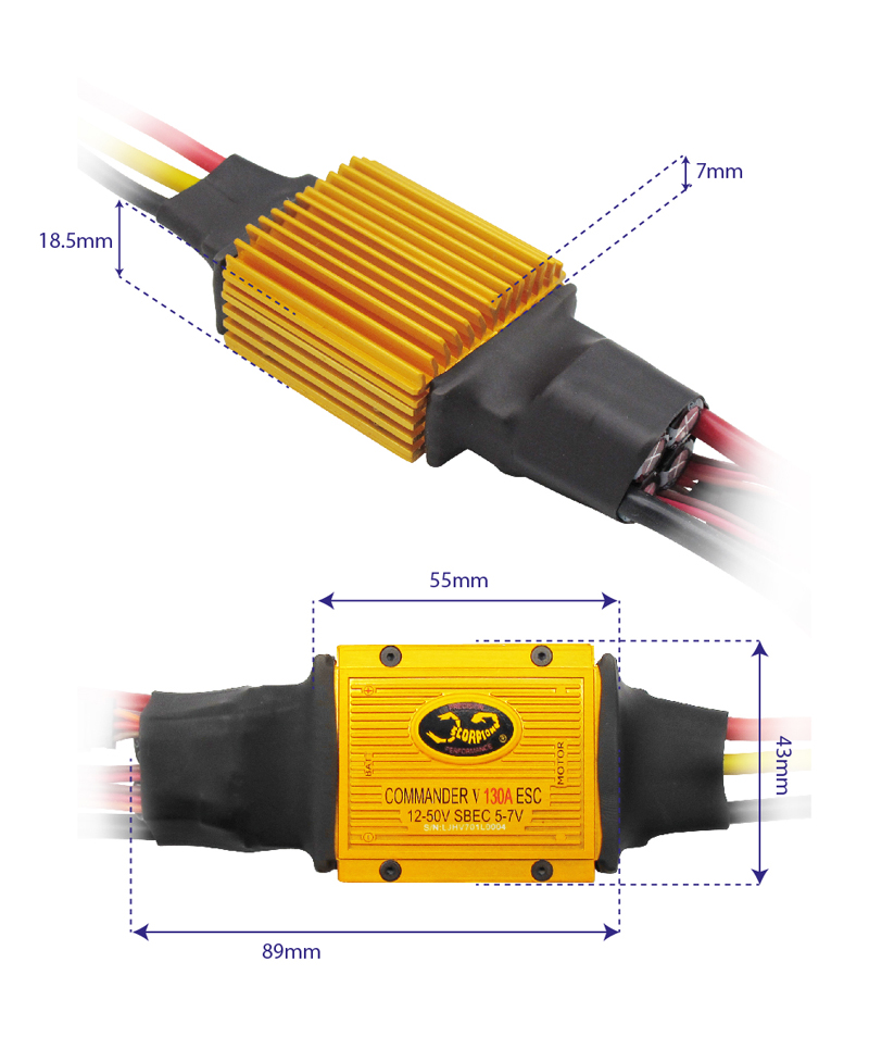

    Now this looks really nice!!
    Looks like a high peformance esc!!

    Just looked on scorpions website and its says its: $349.99,
    Ive also found some more info on it!! Its got an impressive 15amp 7.4v bec!!!! WOW
    This fifth generation of Scorpion Commander V 50V SEBC series features with an internal switching BEC (rated as 15Amp peak with 5.4V, 6.2V and 7.4V selectable), plus new external governor mode (AIR 2) for auto throttle calibration, it also included an external adapter for future firmware update by PC.
    Low Voltage Cut-off (12V to 48V at 1.0V increments) no need to select battery type just set the voltage the ESC should work on, by doing this, the ESC will be compatible with any future type of battery designs.
    LVC= LOW VOLTAGE CUT : 120(12V) TO 480(48V).
    BRK= BRAKE SETTING: 1: NO BRAKE, * 2: VERY SOFT BRAKE, 3: SOFT BRAKE, 4: HARD BRAKE, 5: VERY HARD BRAKE
    AIR= 1: Activate Airplane mode, 2: External Governor mode
    PCT= PROGRAM CUT TYPE (LVC TYPE): 1: CUT 50%*, 2: NO CUT JUST LED WARNING, 3: PULSE WARNING
    MAT= MOTOR ACCELERATION TIME DELAY: 1: 0.15 Seconds* (recommend for AIR 2), 2: 0.3 Seconds, 3: 0.45 Seconds, 4: 0.7 Seconds, 5: 1.3 Seconds
    CAR/B= DISABLED
    COP= CURRENT OVERLOAD PROTECTION: 1: PROTECTION ON*, 2: PROTECTION OFF (CHOOSING OPTION 2 WILL VOID WARRANTY)
    FREQ= DRIVE FREQUENCY: 1: 8 kHz *
    SS= 1: SOFT START WITH OUT GOVERNOR MODE*, 2: SOFT START WITH GOVERNOR
    TIM= MOTOR TIMING: 1: AUTO TIMING*, 2: 5 Degrees (Recommend for GOV 1), 3: 15 Degrees, 4: 20 Degrees, 5: 25 Degrees, 6: 30 Degrees
    GOV (P Gain) = POWER GAIN: 1 to 11 (SOFT to HARD), DEFAULT: 5*
    SB (I Gain) = CURRENT GAIN: 1 to 8 (INSENSITIVE to SENSITIVE), DEFAULT: 5*
    SOFT START DURATIO: 1. SHORT 10 Seconds, 2: MEDIUM 15 Seconds*, 3:STRONG 20 Seconds
    *Factory Default
    Specifications
    Weight (Without Connectors) 200g (7.05 oz)
    Max Continuous Current 130 Amps
    Operating Voltage Range 12 to 50 Volts
    Max BEC Output 15 Amps peak @ 5.4 - 7.4 V
    On Resistance 0.68 mOhms
    Size 89 x 43 x 25.5mm (3.5 x 1.69 x 1.00 in)
    Included in the Box
    1 x Scorpion Commander V 50V 13A ESC (SEBC)
    1 x Scorpion IR Transmitter (Programming Card)
    1 x Scorpion IR Receiver
    1 x Instruction Manual Weight including packaging
    450g

    Be careful on the BEC rating. The 15A figure is peak, which usually means it cannot be sustained for very long. The continuous would be of more interest.

    Good shout, I would expect it to be around 7.5a-10a continuous but I have emailed and asked the question.

    suppose a cc bec pro would be a good choice to use!!!
    As the Jive is rated at 5A with a 15A peak and I have seen some serious stick banging on 90 sized models then the internal bec will be fine if it has the same or exceeds that of the Jive. I would hope you don't need to use an external bec, that kind of defeats the object when the overall size of this thing big.

    Yes, many dont trust internals at all, just I would not use a CC BEC pro after mine went pop on 12s.
    a WR would be my choice if using an external, but I use KT as I want the internal BEC so if the Scorpion can offer the same performance then thats where my money will be going
    As a straight comparison of current capability and BEC performance this unit is $200 cheaper. As you say if it does work as well as a KT then it will be a very good buy. On top of that it has the phase sensor built in for v-bar governor hookup.

    10a continuous is the reply from Scorpion
